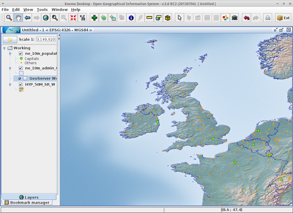

- The layer will change its style to reflect the changes:
- If you make enough zoom in to reach the given scale, both rules would be rendered:
Note
When the map is at full layer scale only capitals are shown. If you zoom in close enough, all the populated places would be shown
