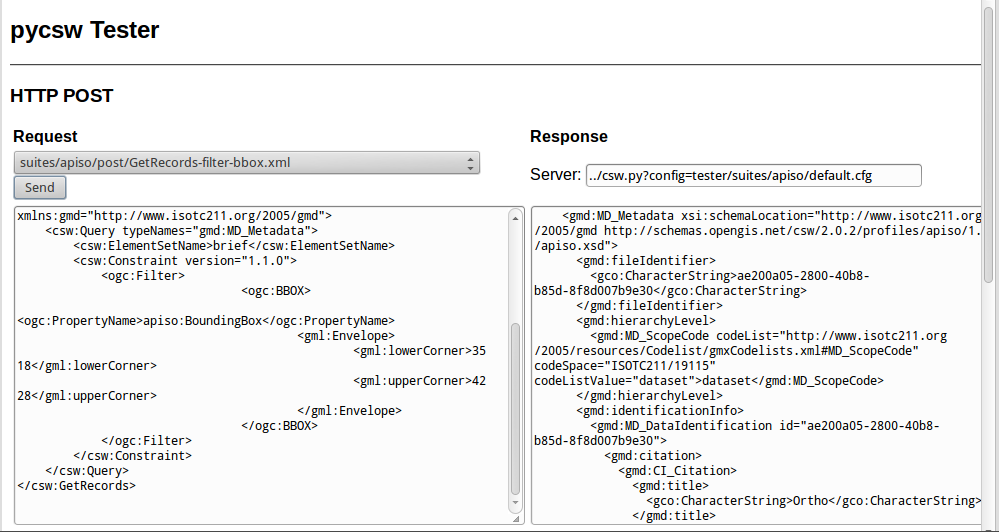

By selecting the left drop-down list, the user can see various predefined POST requests, encoded as XML, that can be sent to pycsw.
Select “apiso/DescribeRecord” and press the “Send” button. A description of the ISO Application Profile record is presented on the right panel.
Selecting “GetCapabilities-SOAP” and press the “Send” button. A SOAP request is sent to the server to advertise their web service capabilities.
You can search for data records, performing a spatial bounding box query, by selecting “GetRecords-filter-bbox” and editing the coordinates in the XML request.
You can go through all the available requests and perform various requests from this testing application.
