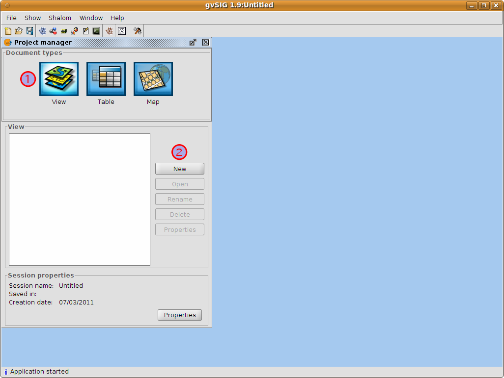

Start gvSIG and create a view
Select gvSIG from the application menu. The application usually takes about a minute to startup.
  1. By default gvSIG opens with an empty project file with the ‘View’ document type selected.
  2. Click on the [New] button to create a view.
../../_images/gvsig_qs_0015.png

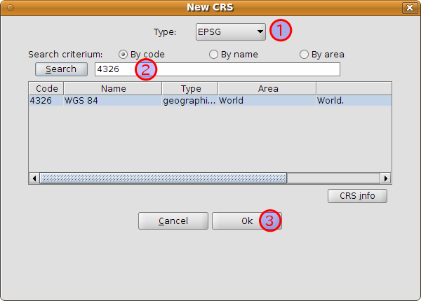

Defining your Coordinate Reference System
  1. Using the dropdown list for ‘Type’, select EPSG.
  2. Enter the EPSG code for the Coordinate Reference System. For this example we are using EPSG=4326, which is the WGS84 2D Geographic Projection. Then click on the [Search] button. This will list the selected CRS in the table below the search input field.
  3. Select [OK] to return to the View Properties dialog.
../../_images/gvsig_qs_0035.png

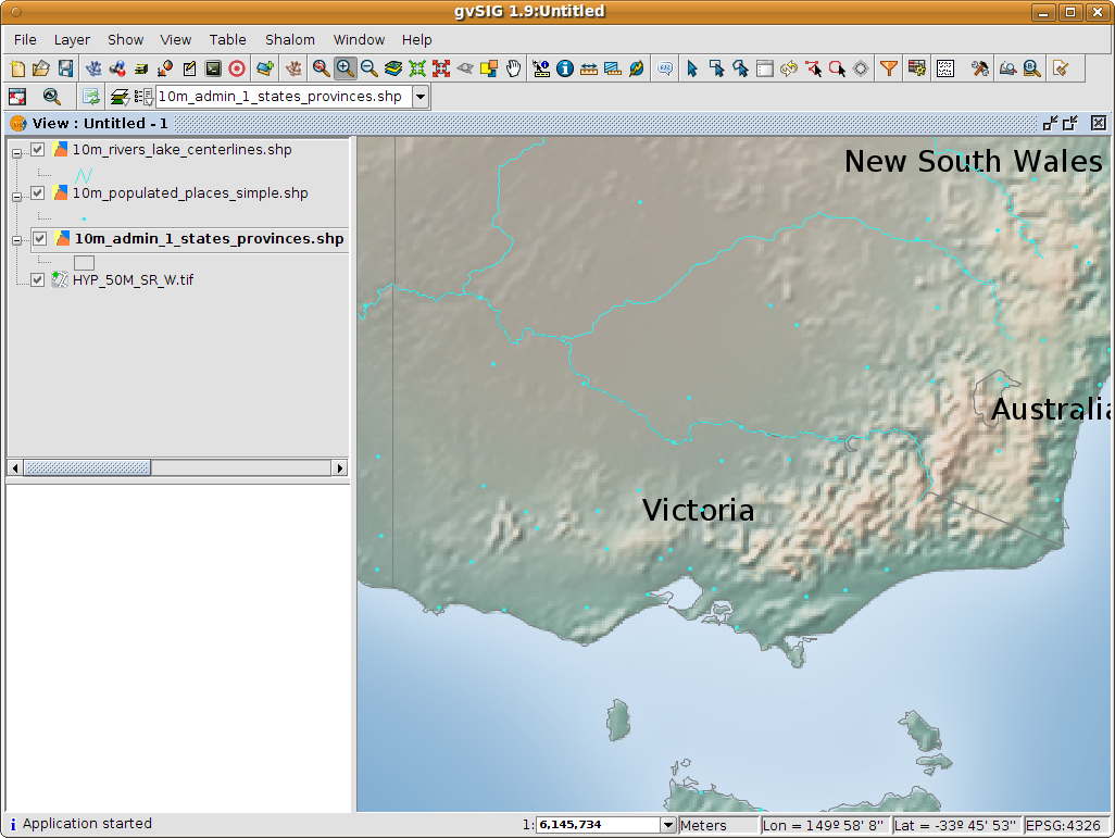

The View - basic navigation
Zoom into a region
Once back at the main view you’ll see the vector files super-imposed over the raster file. The colours shown in this screen shot may differ from yours depending on the user preferences.
  1. By default the Zoom in tool is selected on the main toolbar.
  2. Use the mouse pointer to draw a bounding box around South-east Australia. Do this by selecting the top-left corner of the bounding box, holding down the left-mouse-button, and dragging the bottom-right corner of the bounding box over the selected area. Release the left-mouse button once you have the approximate area defined.
../../_images/gvsig_qs_0095.png
Fine-scale navigation
The view will automatically change to show the area within the selected bounding box.
  1. The size of the Table-of-Contents column can be adjusted using the mouse to help see long file names.
  2. Adjust what is shown in the view by using the highlighted tools, so that Victoria is central.
../../_images/gvsig_qs_0105.png
