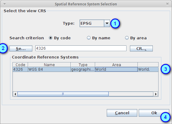

  5. Select the option EPSG in the SRS type combobox (1), insert the text 4236 in the text field and press the Search button (2)
  6. Select the SRS EPSG:4326 - WSG4 (3) and press the Ok button (4)
    ../../_images/kosmo_select_srs_epsg_42365.png
  7. Press the Ok button again to select the SRS loaded. The view will start with EPSG:4326 as the base projection

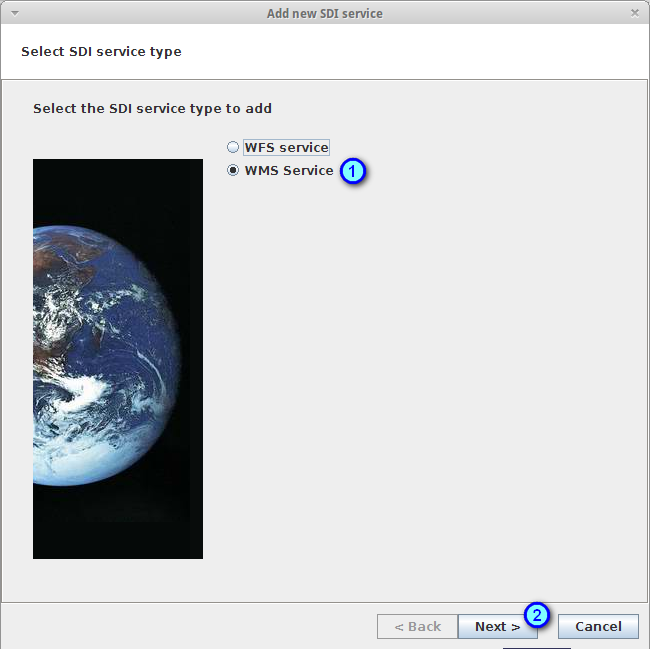

  3. In the Select SDI service type panel, select the option WMS Service (1) and press the Next button (2)
    ../../_images/kosmo_wms_15.png

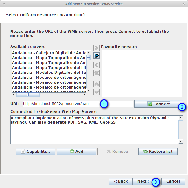

  4. In the Select Uniform Resource Locator (URL), type the URL http://localhost:8082/geoserver/ows?VERSION=1.1.1 (1) in the corresponding text field and press the Connect button (2)
  5. If the connection is successful, press the Next button to go to the next panel (3)
    ../../_images/kosmo_wms_25.png

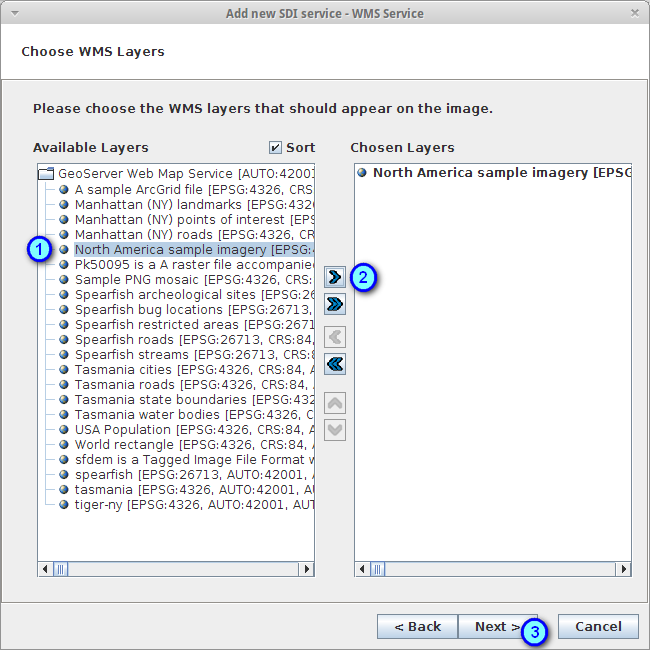

  6. Select the layer North America Sample Imagery (1) and press the > button (2) to move it to the right list. Press Next button. (3)
    ../../_images/kosmo_wms_35.png

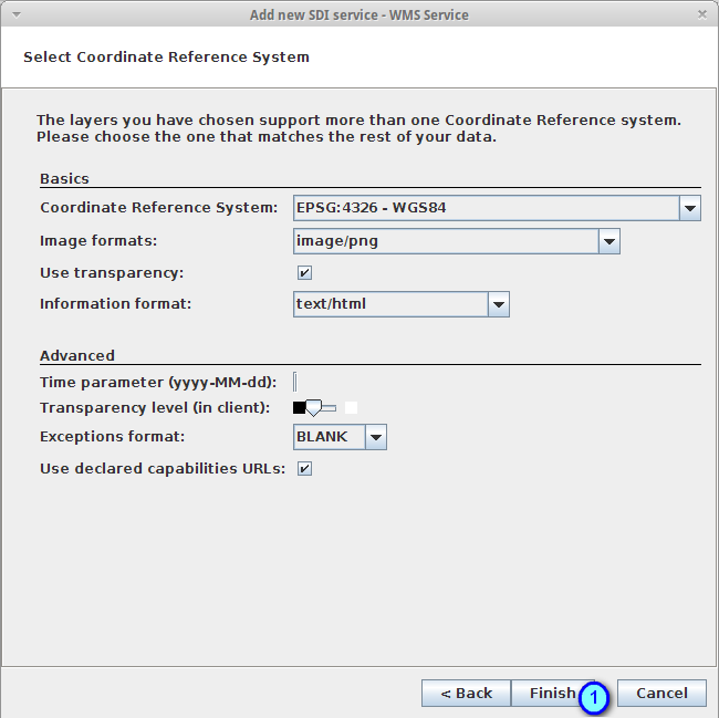

  7. Leave the default options loaded and press the Finish button (1) to start the layer loading
    ../../_images/kosmo_wms_45.png
