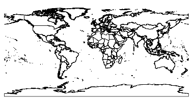

> plot(countries)
This gives us a simple map of the world:
../../_images/r_plot16.png

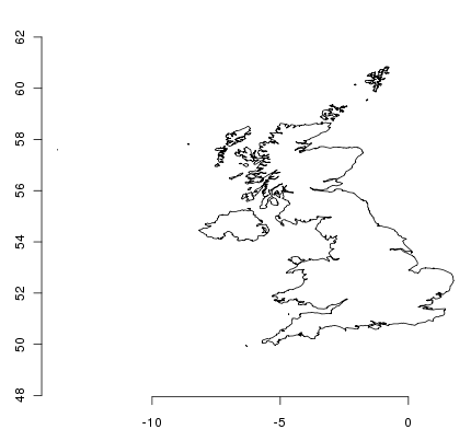

When an OGR dataset is read into R in this way we get back an object that behaves in many ways like a data frame. We can use the ADMIN field to subset the world data and just get the UK:
> uk = countries[countries$ADMIN=="United Kingdom",]
> plot(uk); axis(1); axis(2)
../../_images/r_plot26.png
This looks a bit squashed to anyone who lives here, since we are more familiar with a coordinate system centred at our latitude. Currently the object doesn’t have a coordinate system assigned to it - we can check this with some more functions:
> proj4string(uk)
[1] NA
