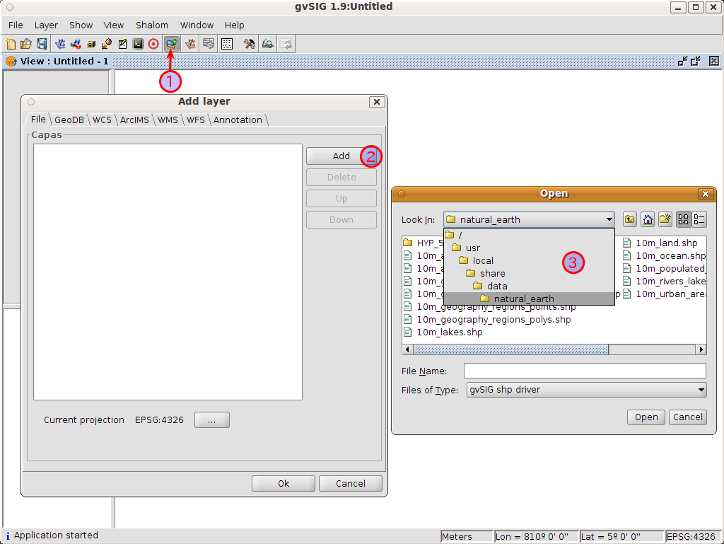

Open the add layer dialog
  1. Click on the Add layer icon in the main toolbar to open the Add layer dialog.
  2. Select Add in the Add layer dialog. By default the first tab is File so the Open file dialog will appear.
  3. Drill down to the /usr/local/share/data/natural_earth2/ directory.
../../_images/gvsig_qs_0065.png

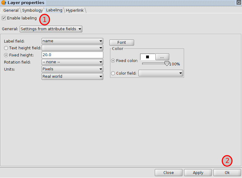

Changing the labelling of a vector layer
  1. Select the Labelling tab at the top of the Layers properties dialog.
  2. Change the text attributes to those shown on the image, then click on the Accept button.
../../_images/gvsig_qs_0135.png
